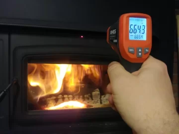

Will you show a picture of where you’re placing the thermometer on your insert?
This is where I take my temps (see laser dot in photo). Usually the hottest spot is as high as I can get on the front face, right at the center of the front of the stove above the door.
  • [Hearth.com] Pacific energy Super insert
That is too hot.
Have you shot the front of your stove above the door? How does that temp relate to the stove top, in front of the flue? I was thinking that the front might be hotter, since the secondary flame is roasting that area pretty good..
If I think about it tomorrow I'll check. There's an airwash deflector across the top of the door opening. I don't run a Summit, but hogwildz does. I am going by his normal reported temps which admittedly are to the side of and a bit lower than TDC.
