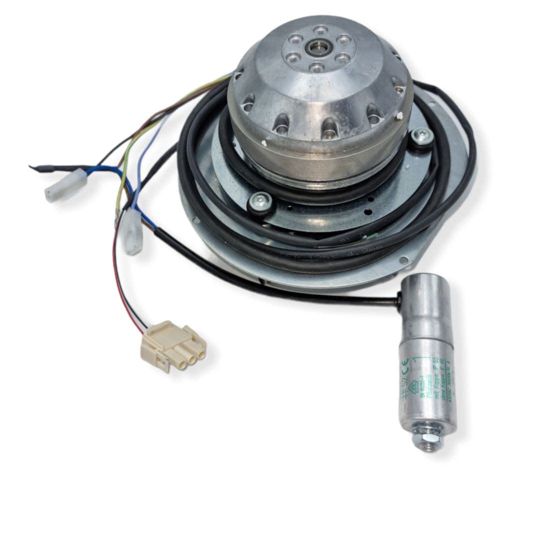

Looking for help, not sure if this is the right spot . I have a Palezetti Prima with at least 30000 hours on it. this has been a great stove. My exhaust fan stopped working yesterday. Can you get replacement parts for this and is it worth it for a stove of this age. Also how difficult is the replacement and access of this blower/fan?

I've got the dreaded "low exhaust pressure" on my Prima again. Hoping Phil can save the day again. I found some parts in Great Britain but, they don't ship to the US. I'm guessing i just need a motor for the ventilator fan but not sure.
Thanks
The exhaust fan on my Palazzetti prima was making squeaky noises, I only replaced the exact size bearing on the back of the motor and now still going strong after two years. You could buy the bearings from Amazon, the same number printed on the old bearing, invest in hi quality Javanese made, I hope this is not too late to help.Ty

Hello, My exhaust fan finally died for my Ecofire Prima. Does anyone know where to get parts? Phil?
Orignal parts
