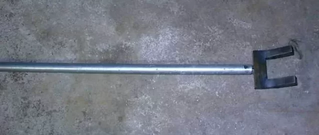

I take them apart with a pallet fork, mine is home made but you can buy them.
Then cut them up with a chop saw, goes quite fast, inexpensive HF blade will go through nails no problem.
