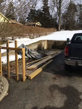

[Hearth.com] Paving the driveway and the woodshed
This was after the end of last winter. Don't worry I moved the last of the wood inside the garage, and still have 2 or 3 loads left. But you get to see the space Im working with.

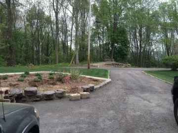

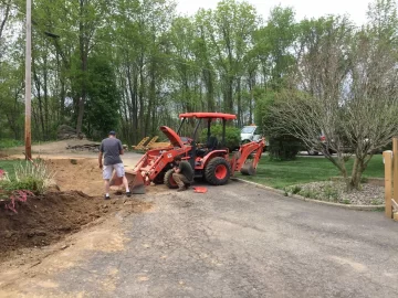

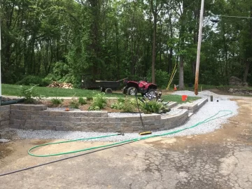

[Hearth.com] Paving the driveway and the woodshed [Hearth.com] Paving the driveway and the woodshed [Hearth.com] Paving the driveway and the woodshed
