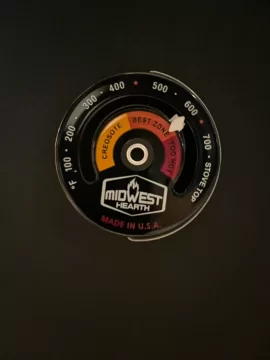

Thank you sir! I installed the new P61a burn pot, platinum control board, and twin blade combustion fan today. She’s a totally different stove than it was with the PC45 parts on it. About 125 degrees hotter on the sides and top of the stove. So far I’m happy with it.

Yes I haven’t changed the igniter over to the new style yet, as a guy on one of the FB forums swore that it would work with the old igniter, and so far it’s working great.
Part number for the board I’m using is 1-00-05886. I have the dip switches set at 1,2,3,5,6,7 all on, 4 and 8 off. It’s set for a P61a with a red esp wire.
