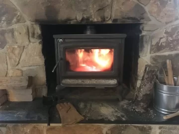

I have my PE summit installed in my existing fireplace. It fits well, but is about 75% recessed in the fireplace. Last year the stove was awesome, but I'm thinking a blower will help me get much more heat out of the fireplace and into the room.

My setup will have the blower buried in the back of the fireplace, basically sandwiched between the back of the stove and the back wall of the fireplace.

I take it that this is a freestanding Summit as opposed to the Summit insert? It will bring the stove more forward. Will the liner connection still work? I would not push it hard up against the back wall of the fireplace, so add another inch there. The blower will get warm, but it will be pulling in room air underneath the stove which will help somewhat. The main issue will be that the controls will be a pain to reach. You'll probably want an on/off switch at the plug outlet or one inline in the cord.

Thanks for the reply begreen. Unfortunately, I don't have much room to move the liner forward. I already have the damper and frame removed and a decent chunk of brick chipped out. I think i will have 2" clearance between the blower and back of the fireplace.

This is my setup... [Hearth.com] PE Summit - Blower Question .
