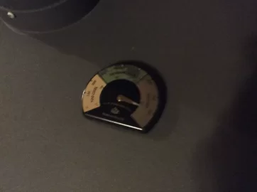

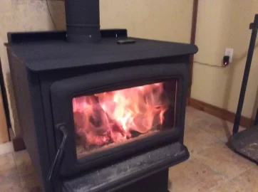

You need to run up a bit hotter. If you are looking for serious heat output you'll want to hit 700-750 stovetop. The picture is blurry(because of the heat lol) but that is 750-800. I'd aim more for 700 when you're first starting to push the higher temps. Don't overshoot.
I'd recommend not using the fan at all when feeling out the top end of the heat range, then if you are getting hot enough to scare yourself you can always turn it on to cool things down.
