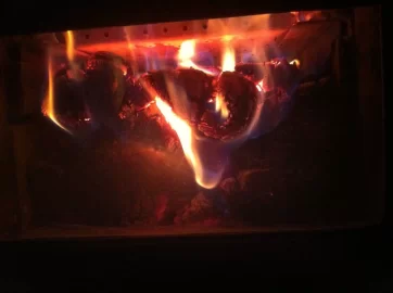

Larch is what I use for overnight burns and I fill the fire box pretty full but not touching the baffle. The spaces between splits I fill with smaller pieces. Once its filled around 11 at night I can leave it until around 9 am when I throw some Lodgepole Pine on the bed of coals that's left. Btus for the Larch are higher than the Fir but I would think it would still work for overnights. Not the greatest picture but I thought I would throw it in. Enjoy your new stove!
I use my Maple for the overnight burns. In my 13, I could load it to the top at 10pm or so and still have enough coals to get some Fir going at 6am. I'm hoping the Super will out-perform that!!!!

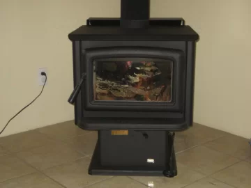

Got the stove installed and doing a break in burn today. Thanks all for the help and tips. I do want to say that just doing the break in burn I can tell already that this stove is 10X the stove that my 13 was in all categories. Also I LOVE THIS STOVE ALREADY!!!!!
[Hearth.com] PE Super 27 vs. TN 19
Congratulations! Looking good.
Reactions: RiverLogger
Looks great. It will pile the heat out and glow inside beautiful.
Very nice. I see you opted not to get the ash drawer...good choice! Used mine about twice. Then I built a metal scoop, custom sized to fit the firebox. One scoop and the box is empty.
