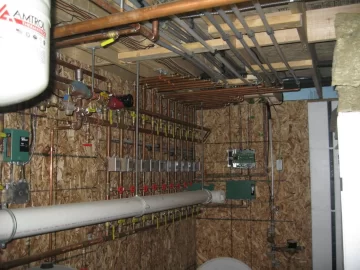

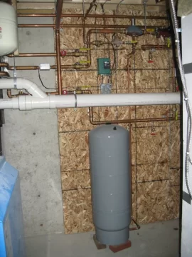

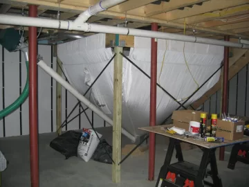

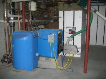

As promised. Here are some pictures of my set up.

Nice looking setup Andrew. How many zones are you running?
I've got 11 zones. 6 for the main house, 1 for the mudroom, 1 for the garage, 1 for the apartment, 1 for DHW, and 1 for future plans.

When I built the new house I decided I'd do the Pellergy system again. I went with a 5 ton bag bin this time instead of the 3 ton bin I have at the duplex. The bulk delivery people around here have a two ton minimum and since it takes anywhere from 4 to 6 weeks between when I call for pellets and when they actually deliver it makes timing when to call them tricky.
I also added storage. I bought a 500 gallon tank from New Horizons. Now when the burner comes on it will run for an hour or more before it shuts down. At the duplex a lot of times when there is a call for heat the burner starts up and as soon as the ignition cycle completes it shuts back down again. Next spring I'm going to put in a 120 storage tank and that should eliminate the short cycling up there.
At the new house the boiler is coming on maybe once a day. I suspect it will come on 2 or three times a day during the heating system vs. the 31 times p/day at the duplex.
Being that the Buderus is an iron boiler, how is the Pellergy burner integrated or set up to protect the boiler from condensation on a cold start?
The Buderus is designed as a cold start boiler so no extra protection is needed.

There is a control unit that takes care of that. I don't believe I'm using the Buderus control box but there is a unit that controls the circ pumps. There is a separate control box for the Pellergy settings such as feed rate and fan speeds.
