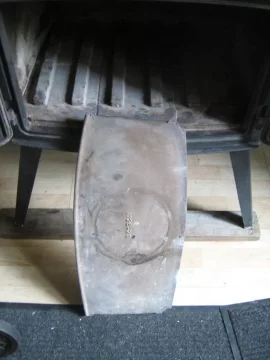

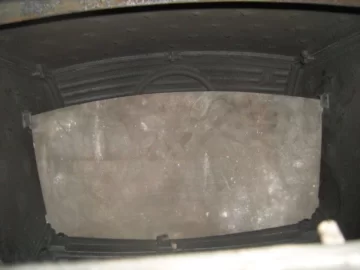

My question is that I have a plate and I'm not quite sure where it goes. I did manage to fit it into the top of the stove and would love if someone could confirm for me that it is the correct place for it.

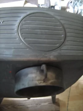

Also, is it preferable to vent out the back or the top? I can do either, but would like to do whatever helps the stove burn better.

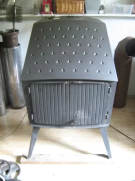

Edit: Here are some pictures, they didn't upload in the order, but you can see the plate I referenced above outside the stove, and in the other picture inside the stove.

Welcome. Lucky you, that looks in nice shape. The plate is the baffle. It looks correctly placed. The best chimney is an interior one, located as close to the center of the house as is reasonable. How tall will the flue system be from stove to the chimney cap?
Thanks for taking the time to reply and complement my 'new' stove :) , as well as confirming that 'baffle' is correctly placed. I took a guess since the person I got the stove from didn't use it, and it sat in the garage for a few decades.

If going out the wall it would be better to top vent the stove to reduce the number of 90º turns in the smoke path by one.

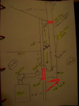

Would it be okay if I posted my install plans to get some feedback? Should I start a new thread, or post it in here?
I'm going to be doing a self install, by manufacturers recommendations of course, but this is more complicated than the Pellet install.
No problem. Posting here is fine. Pictures help us see what you are seeing.
Okay, here it goes.
Here is my outline I drew up. I'm no artist, obviously, and didn't plan on posting this but it might help on seeing what I'm dealing with.

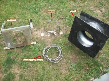

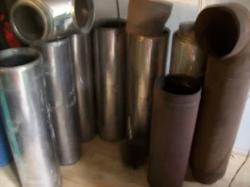

Here are my accessories and pipe
[Hearth.com] Pellet burner here with a couple of Questions about Morso 1125 that I just got. [Hearth.com] Pellet burner here with a couple of Questions about Morso 1125 that I just got.

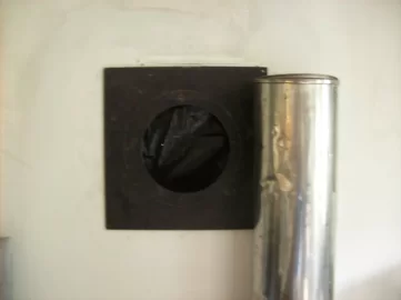

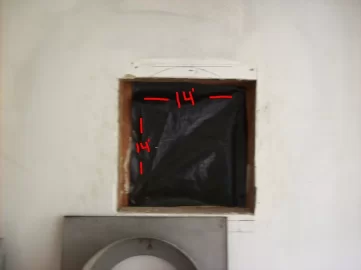

Here is my rough opening for the thimble, a double insulated pipe will go through to the outside. The Pipe will extend 3-4 inches on the inside of the room. The Black pipe is 18'' away from combustibles. The opening is 14'' x 14'' and I don't plan to insulate around the inside. As far as my research tells me I'm good with my clearance to combustibles with the Thimble and Double Insulated Pipe, am I correct?

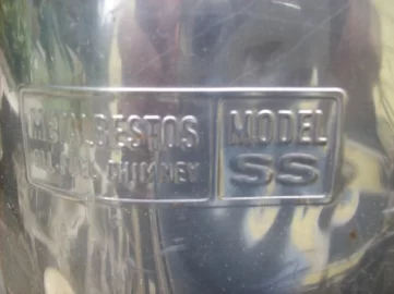

The double insulated pipe I'm using is Metalbestos Model SS All Fuel Chimney. I've researched and found that this product is still acceptable and compliant if the 'Connector Straps/Bands' are used. As I understand the Model SS failed the 'UL HT103' rating at the chimney twist-lock connection at the 2100 degree burn, and the Connecting Bands brought it up to code and are required when using this product.
Here is where I have a question. I'm going to have a 10' foot run of pipe to where I plan on using the wall strap, and I plan on attaching it to a 2x4 attached underneath my soffit joists, or attach it right to my Fascia. I'm still not sure about this one because I have to run it in front of my gutter, because I don't have room to go through my soffit.
I also read that you should brace with wall straps about every 8 feet, am I alright going to 10' feet, then using the wall strap? The wall support I'm using is able to support 30' feet of pipe.
I'm also OK by the 10/2 rule if anyone was wondering. IE: Highest point 10 feet away and 2 feet above that.
Anything I missed here in my plans? Suggestions?
