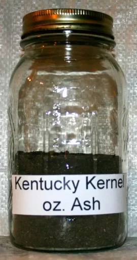

    Kentucky Kernel results.
    Temp average 243ºF
    Ash volume was about the 13 ounce mark.
    Ash weight 6.592 ounces
    Ash Percentage 0.515%
    Fines were very low at less than 1/8 cup both bags
    Notes:
