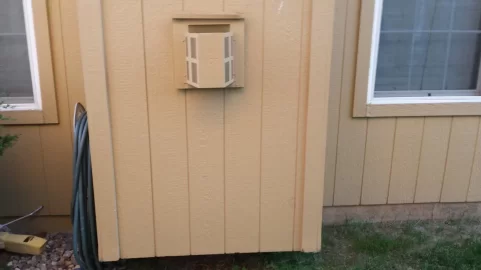

I guess it wouldn't be a true alcove its a pseudo chimney bump out off the side of the house. About 8 feet tall 2 feet deep and 4 feet wide. It has a vent on it I'm thinking incase the builder put in a propane fire place. We have no gas in our neighborhood. The vent assembly is stuffed with insulation to plug it off. Like I said i'll post pics today when I get home.

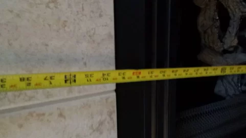

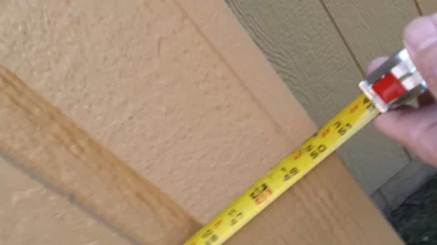

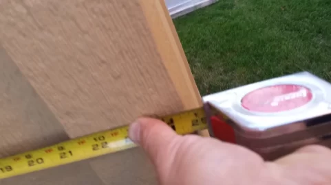

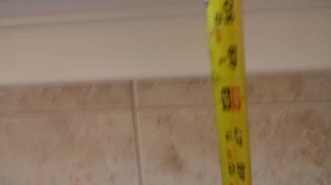

Here are the pictures
The unit
Exterior wall
Width of unit
Height of unit
Width of exterior wall
Depth of exterior wall
Distance from hearth to mantle
Local Harmon dealer wants 7 grand to install don't see that happening[emoji16]

Have dealer give you details on what is included in the $7,000.00 install price.
Bring him over and ask $7,000.00 worth of questions!
Bill
7k sounds steep! Has your dealer come to your house? I love my new p43,but I paid 3k. At that price I would seriously consider a different stove; and i would tell said dealer the same thing!
If I can get away with it insurance wise I'll do it myself. Don't have a price on the stove yet just heard 5 to 7 grand. I'm thinking they just lost the install fir sure
Have a dialogue with that dealer. They are looking for business. Also, you will need them for the warranty (if you buy a harman, which it sounds like you are looking at). Honestly, my garage had an air entrance for the gas boiler. It consists of a 4 inch plumbing pipe coming in from the exterior. That is the "combustion air consideration" that is required by code. Venting into or through the garage isn't the worse option. Although, house combustion air is okay too (as I am using) I would be interested in drawing an oak down your chimney. Seems like an ideal option
I had the same issue. The dealer said leave the fireplace alone and just put in a free standing stove. That is exactly what I did
So I see where the Harmon requires a kit to install as zero tolerance and the quadra fire does not. Hmmm? Still reading reviews on line @ wiseheat. Is there anybody on that board that has anything good to say about a stove?
I just put a quadrafire classic bay 1200 insert into a prefab fireplace. For zero clearance installation (not into an existing prefab fireplace) you need a special shroud piece for the stove and a couple other parts as well as certain distances to combustibles. When installing into a prefab fireplace you need certain distances to the metal firebox.
I would take a look at the installation manual to get a better idea of what is needed which can be found on the website. Might be best to remove the electric fireplace all together and either install an insert as a zero clearance or a free standing stove each with a direct vent. I would think you would need to do some insulating of the exterior wall.

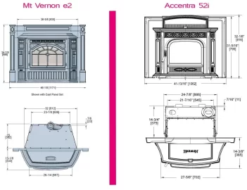

You should be able to get the Accentra 52 i in there since you basically have a dog house for a zero clearance gas fireplace. Installation with this stove, zero clearance cabinet and outside air kit should be around $5.200. Check your hearth and clearances to combustibles on the front. You should be good. [Hearth.com] Pellet Insert into an Electric Fierplace
