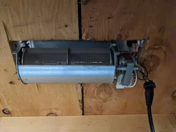

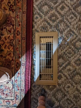

When I first started using it I was a bit disappointed in the heat circulation. The family room was great, but the kitchen, living room and dining room areas were cool. There were 2 4x12 vents in the floor in the dining room, with the wood stove under there the heat was so intense it drove the heat up those vents on it's own, not so with the pellet stove.
I bought 2 of these Tjerland RB12 fans(https://www.amazon.com/dp/B005FNL0SS/?tag=hearthamazon-20) register booster fans for the 4x12 registers. Wow what a difference, it certainly balanced everything out and now I am very happy with the set-up. The upstairs and family room are now consistent. The bedroom area is cool, but I like it that way.
I bought 2 of these Tjerland RB12 fans(Amazon product ASIN B005FNL0SS) register booster fans for the 4x12 registers. Wow what a difference, it certainly balanced everything out and now I am very happy with the set-up. The upstairs and family room are now consistent. The bedroom area is cool, but I like it that way.

The registers are not a part of the HVAC system. They are simply holes cut in the floor, they were in the house previously because there was a wood stove in the same location where we installed the pellet stove. The wood stove was hot enough that it would drive the heat up through the open vents in the floor. The pellet stove was not really hot enough to just force the heat through the vents, which is why I installed the register fans to help move the heat. They are actually designed for use in HVAC systems, but fit and worked perfect in the open vents that were cut in our floor. I hope that helps to explain our set-up. Don't hesitate to ask any other questions.
The registers are not a part of the HVAC system. They are simply holes cut in the floor,...
That makes sense now. I don't have these registers already in place. I am not sure if the code allows it if I cut the floor and install those myself. Probably not.
What does it look like from the ceiling downstairs? Are they the same size 4x12 opening or a larger size--a larger size on the ceiling would make sense to gather the heat more efficiently. I also imagine there has to be some kind of duct connecting the ceiling opening/registers with the floor registers. I mean, it can't just be the floor joist in between, right?
Once I go this way, there is no turning back. I mean I will cut the nice hardwood floor and put holes in the ceiling. So better make sure this has a better chance of being successful. :)
Our basement underneath is the lowest of the 4 levels and it is not finished. There is a drop ceiling down there but the tiles are removed above the pellet stove. Since it isn't a finished space it really doesn't matter, it is dry we store our pellets down there as well our washer dryer is down there. I attached a picture from the basement and from our living room to give you an idea of what it looks like.

Thank you so much! That explains a lot!
I am doing more research and I think the next thing is to talk to my local fire department to see if code allows this. It sounds like in my case(ranch, with a walkout basement) the code might allow it.
As far as the floor registers are concerned, since I have a finished basement with drywall ceiling, I will have to make some kind of duct/enclosure between the floor joists and make it look nice.
Thanks again for the pictures. They are really helpful!
