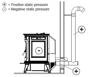

Your venting should look something like this:

What are thoughts of putting in a 45 elbo the up of the other shorter roof ( The taller roof is about 30 feet up and super high) .. does anyone suspect it would cause a draft issue especially in power loss situation? I attached a photo with a really rough example of what I'm talking about for an idea
