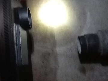

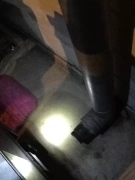

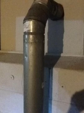

Thanks for the reply guys, here are some pics. Will be a little dark as I'm running it out of the basement and lighting is not the best.

Remove the existing vertical pipe & replace it piece by piece, starting from the stove adapter, to see what you need to make it work.
An adjustable length or one short piece & you should be good to go.
Just make sure the manufacturers of the old & new (if you need it) are the same.
