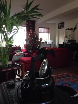

I'll keep you posted, my 100 year old bluthner grand ( recently restored) shares the room with an Oslo, its 15 feet from the stove.
Since a year I monitor humidity. Since the stove arrived there is no change in humidity compared to using the central heating. Up until now I've only burned wood. The piano is not detuning.
The temperature swings are larger but, since the piano weighs 600 pounds , I guess it takes time to really warm it up.
In summer, without stoves, there can also be large swings from day to night.
So I try to watch humidity and will see what winter brings us.
