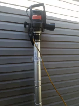

Just did the lbt to mine after running 2 weeks. Looked like a diesel trk. Unreal what came out. [Hearth.com] Pellets feed too fast
