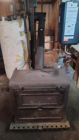

What stove is this for? Can you post a picture of two of the setup, indoors and out?
I'm interested in people's thoughts on the perforated baffle.

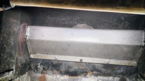

|It sits in the house basement- Here's the baffle.
(you can see where the perf tube would sit)
[Hearth.com] Perforated SS Tubing as Baffle
There's near 6' of pipe going to the chimney, and the chimney is just a house chimney.
I just moved it, and cut a vent over it in the floor.
Reactions: Burnin Since 1989
I don't particularly like the perforated stainless idea. It's a leaky sieve that looks like most of the air would enter the firebox at the air entry point(s). A secondary tube, with properly sized and spaced holes would seem to be more uniformly and evenly efficient. I'd also consider extending the baffle more forward, maybe by creating a shelf that stops a few inches before the door? Is the firebox firebrick lined?
There are several past threads in this forum on this type of conversion. Search under 'adding secondary'. Here's an example:
