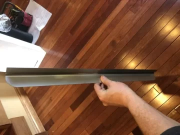

Hello,
while moving in a partially disassembled Progress Hybrid today, this part fell out/off of the stove. What is it and where does it go?!?! Thanks in advance for your help!
[Hearth.com] PH mystery part
I don't know, but it looks like it might be an air deflector. Perhaps for the window airwash? Send a pic to Woodstock and ask for a parts diagram.
Thanks. I did email them the photo after hours. Hopefully it won’t make a difference for the seasoning fires I have going on right now.
Ha! You lit it anyway?
Mike at Woodstock got back to me this morning (a Saturday no less... LOVE this company). The mystery part is the “metal stone edge liner” and goes under the cooktop at the rear to keep the stones from marring the cast iron. Here’s a pic.

Nice touch and good service!
I love Woodstock Soapstone Company! Their customer service is second to none and they stand by their product.
Yep, whenever I've had a question, Mike has been all over it with a quick reply and good info.
