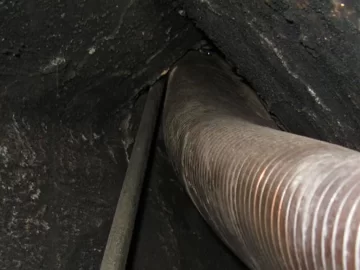

Pic of inside my masonry chimney. Do I have a lot of Creosote?
Depending on what state you live in, you can technically run a piece of 5 foot oval pipe and be done with it.... I would highly advise against it... the insulation part.. that's a different story... some say it's great other's say it doesn't matter.... I say your putting a rust resistant product in an area prone to water and your going to eventually end up with an insulated wet matter. What I would probably do in your situation is run a piece of ovalized to round flex from your insert to your cap... You'll have better draft and a safer fireplace.... let me know if you have any questions... others that have chimed in have added valuable insight as well...
'Chain Whip' your chimney !!!
NEVER-NEVER let that company near your chimney again !
They will probably crack and damage your liner (big bucks) and charge you 400.00 bucks for their pleasure.
Might not even tell you that they broke it. It is only clay tile you know- can be scrubbed with a wire brush but it has never done anything to warrent a 'Chain Wipping'- It is just plain stupid.
Looks clean, for safety you might want to consider a liner and new thimble connection, cap looks good from here.
Best o Luck
(sorry for yelling, NEVER-NEVER, but I still mean it.)
My uncle chain whips his chimney every year. No problems there so far.
I'd still recommend the liner though.
Ichain whip or cable whip problem flues everyday for around 99.00. Been doing this for many many years and have never damaged or used this as a reline tactic ever. Please remember all sweeps are not out to get you... Some of us actually enjoy making people safe.

What do the pipes in the pictures do? They seem like something strange that I haven't heard of in a chimney before...
Looks like you might be able to get a round liner through the damper, or you might have to cut it, not sure.
Given that your current chimney looks like it meets code standards for fire safety - it has clay tiles that appear to be in good condition, etc. I would say that you don't need the insulation from the standpoint of fire protection. The liner will basically improve your cross sectional area situation (which might be a code requirement depending on just what size the existing tiles are) It would probably improve your draft but the difference might not be needed / worth the extra cost.

No problem getting anything through that damper. They opened that sucker up big-time. The pipes are in there to support the oval section of flex so it doesn't slide back down into the fireplace.

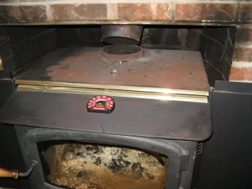

The 2 pics that have me curious are the most recent one you posted of the flue collar connection, and the original one.
Does that liner come down and fit easily into the top of your insert?
In your original picture, it looked like it wasn't in all the way, and I believe you said it had pulled out.
In the most recent picture, where you show the pipe out of the collar, it looks to me like the angle is wrong (i.e. the hole in the stove isn't far enough back for the pipe to insert easily).
Am I reading too much into your picture? Or is the alignment slightly off?
I ask because when my insert was installed, the installer ran into the same problem. The round liner couldn't bend enough after it came into the firebox to match up to my flue hole. Instead of bending the liner, an offset box needed to be installed.
If you do have this problem, you may need to plan to correct it.
Yes the flue collar connection with the crimps is very hard to get to fit right. I'm not happy with it either - just another reason to go with the full liner and all new connections.

The damper area is pretty well clear. Actually I was surprised how much of the damper they cut away so I'm positive that a round liner will work.
I understand what you mean about the offset box. I don't think I'll need one if the liner is flexible (the oval liner that I have isn't very flexible at all from side-to-side - I think it has to do with the oval shape itself.
I don’t think I’ll need one if the liner is flexible.
I have a flexible liner, which is a bit of a misnomer.
Yes, it's flexible, but in the sense that it will bend over a span of several feet, at moderate angles.
No chance of making a sharp turns, at least with the flex liner I had, which in my case is what was needed to make the connection without offset box.
