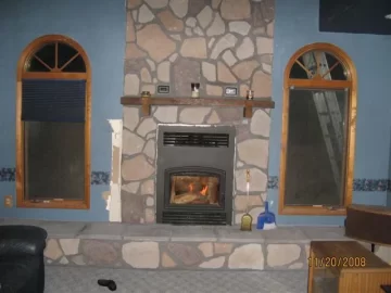

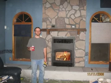

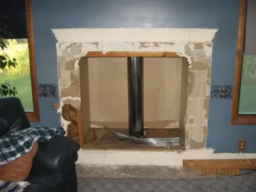

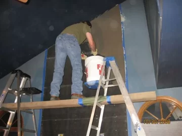

I decided to share some pics of my project last year. Removed a POS Heat-a-lator and installed a RSF Opel 3. I learned much from combing through these forums during the process.

What type of stone is that? Do you have a black ceiling?

It's a manufactured stone, I'll find out the name of the company and style and repost tomorrow. It's not one of the well known companys, not as realistic I suppose, but good enough for me... and much cheaper. The ceiling is navy blue. We have a projection screen and it does not like light!

Wondering what the two rectangles above the mantel are? Nice work!
The one on the left is just a 110 outlet. The one on the right is the blower control for the central heating option, which btw I don't recomend.

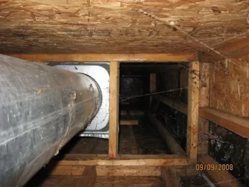

With that in mind I have a question about the 4th picture, what is that galvanized ducting pipe that comes up the left side of your stove and loops down on the top?
I'm guessing by your last post that it ties into your central heating ducting?

Exactly. 8" duct that I insulated. The raised hearth hides its path into the basement. It dumps into the existing HVAC duct as close to the plenum as I could get. 20' or so... that is where the blower is located which is nice, because it cuts down on the noise.

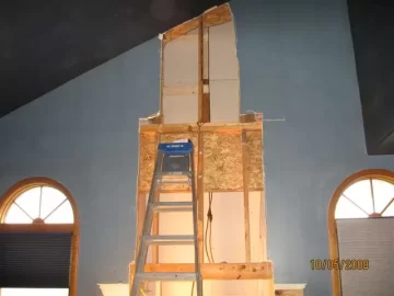

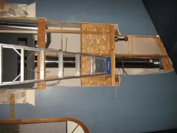

It looks like your chimney runs up the outside of the house and the fireplace is in an exterior box. Did you insulate the box and chase? Have you had any issues with poor draw?
The chase is on the exterior. It originally was not insulated. I insulated it as recommended on the three exterior sides. (uninsulated on the enterior wall) I only have draw issues when the spark screen on the chimney cap gets clogged with creosote. I'm sure that will not be an issue once I quit having to burn wood that hasn't been properly seasoned. I will mention that when I cleaned by cap, (had to do it twice last season) the flue itself was quite clean.
If you have the space build your chase inside, it will be more efficient.

I am a DIY kinda guy and I did it. Do your homework, follow instuctions to the letter and so can you. It will take longer and cost more than you plan.

Sorry for the delay, I didn't get your last post. It took about 2 months, worked on it evenings and weekends.
