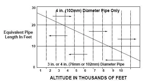

this chart is interesting....
from the manual:
"If you fall below the diagonal line, 3 or 4 inch (76 to 102mm) pipe may be used. If it is anywhere above the diagonal line, a 4 inch (102mm) diameter pipe is required. The chart reveals that a 90° elbow is 5 times as restrictive to the flow of exhaust gases under
positive pressure as 1 foot of horizontal pipe, and a foot of horizontal pipe is twice as restrictive as a foot of vertical pipe

based on the chart, looks like 3" or 4" is fine, but they don't ellaborate more stating why you'd want to install 4" even if the 3" pipe qualifies.

Well, again, based on what you said about his install, it seems that if the EVL is close to or under 15, I'd go w/ the 3"....I don't see the need to spend the extra $$ on larger pipe if it's not needed. I still stand by what I said above, that I think the 3" pipe will keep the exhaust velocity up, and should result in a cleaner pipe (given a clean stove and clean combustion blower), but again, that's my opinion.
