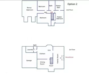

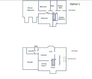

I've attached a layout of the 1st/2nd floor. The 1st pic shows what I referenced in my 1st post. Install a ceiling fan and use reverse to pull air up (C/F in red in the pic). Labeled with the blue X would be the cold air duct locations. An inline duct fan would be used at the top of the hallway to push cold air down to the 1st floor and aimed at the stove. It's really the only location I can install ducting with some serious demolition.
The other option I'm considering (2nd pic), shows the same thing, but the cold air duct would terminate infront of the woodstove (running under the family room flooring, but I'm not 100% sure if this would have a negative impact on stove functionality or if it would be more effective or not than option 1.

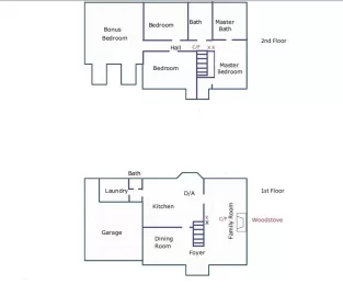

A 3rd option I thought about (3rd pic) was using option 1, but then putting a pass-through grate/grille between the top of the family room wall and the stairwell. I figured this would give the warm air a better path to rise than trying to get around the stairway wall.

First thought I had was to open up the wall to the staircase or at least put a high, large vent on it's dividing wall. This could be a trimmed opening, framed between studs. If you are going to cut a vent I would start with one in the master bath room on the outside (upper wall in diagram) wall. Then test and see how the temps equalize in the MBR.
