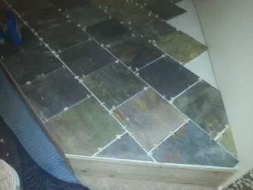

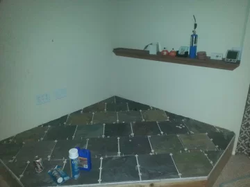

My BK Sirocco should be installed sometime between Thanksgiving and Christmas it sounds like. Unfortunately they need to rent a lift/boom to install the exterior chimney so that added some extra cost but I am hoping to have them install a chimney in our apartment down in the shed at the same time to get maximum value from that additional cost. In the meantime I have been working on the hearth construction - 2x10 frame, 5/8 particle board, 1/2 durock and then natural slate tile. Just waiting on the mosaic front pieces to come in for the face and then grout/seal and should be good to go. Also started collecting various stove accessories such as MM, IR gun, CO2 detector, torch and weather station with a bunch of remote sensors for various areas of the house. All this excitement has motivated me to start on wood for the future (have a cord under 18% and a stash of eco bricks for this year so far) as well so I've been felling trees and splitting the last couple weekends. Was going to buy a splitter but decided to go with the Fiskars instead based on this forum (and hard to justify not splitting by hand when I am under 30 years old...). Thanks all for the advice and motivation - this site is an amazing resource. Will post more pictures once the hearth is done and as the stove is installed...
(Hopefully the pictures work - when I hit preview they just show as links)

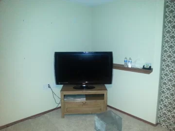

Before:
[Hearth.com] Planning for first stove in MN

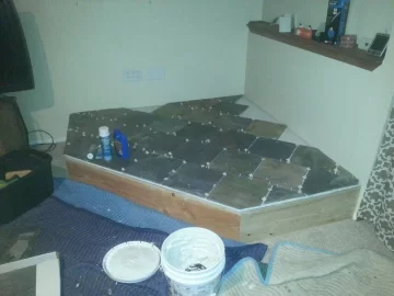

During:
During:
After:

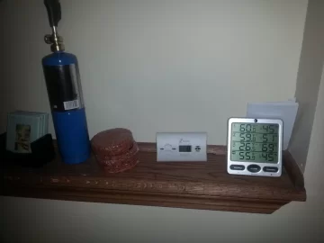

Fun with stove accessories:
Starting on next year's wood:
Reserve wood for this year once the dry oak, ash and maple is burned up:

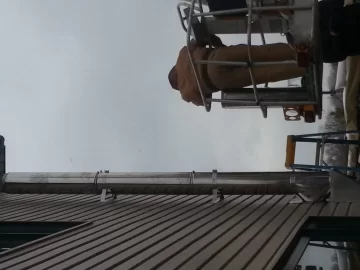

Tomorrow is install day. Hearth is ready to go and I will be working from home to keep and eye on things and take pictures. Since i have to pay for the lift rental anyway my dad is having them install a 12' chimney kit in his apartment (in our pole barn) at the same time as well (he's waiting on an Englander 17 from HD since the first one showed up at the store with significant damage). I'll post pictures once its all in the books - my wife thinks I am a nerd - so excited!
Reactions: Woody Stover
sounds like your already addicted and you didn't even lighther up yet;lol have fun

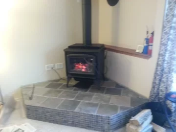

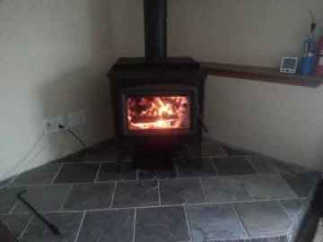

The Sirocco is installed and currently stinking up my basement as the paint cures. Everything went well and seems to be running just fine so far with the cat well into the active range and glowing (thermo right on the upper edge of 'normal') and the stove top at 450 in the corners and just over 700 right above the cat. Picture story below.

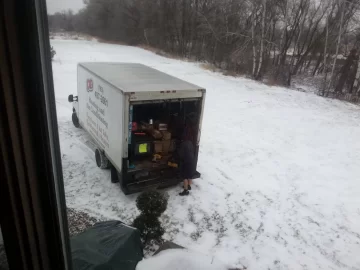

The truck arrives...

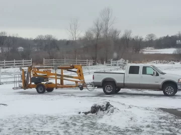

Then the boom (6/12 roof + ice and snow = $500 boom rental)

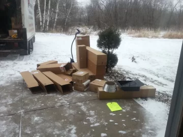

And all the components are accounted for...
So the chimney goes up... (can't figure out how to rotate the picture once its in here)
And the inside work is done...

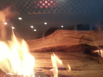

So it's time for the first fire...
And fingers crossed that the smell is gone by the time the wife gets home...
Thanks to everyone who contributes to this site - without you all I would not have ended up with anything near this set up and I would have even less clue what I am doing...
Coming up next; the apartment install pictures (they are working on it now). In case anyone is interested in the technical part they used all Selkirk components. We have I thinnk 18' of class A outside the house and it's double wall stove pipe. the stove pipe is running around 225 currently - seem reasonable?
Measuring the surface temp of a double wall pipe won't really yield much useful information. If the installers are still there, ask them if they have a probe thermo on the truck they can install for you.
ETA: Nice looking install.
They actually said they normally do but were out or didn't have one so if I stop by the shop they'll give me one to install. The pipe temp dropped a lot once I turned the thermo down a bit though. Just shut the door and windows so starting from 50 in the basement. We'll see how quick it heats with the fan running...

So far I can't say enough about the sirocco. Have tried a number of settings and fan speeds ranging from about 16 hour burn set near 2 with no fans to a 7 hour on max with fans almost all the way. Reloaded tonight at 7 and shut it down and wife said "I think your fire is out" tried showing her the cat probe and glowing cat but no dice so turned off the light and she saw the glow and could still fell the heat so she's sold.
