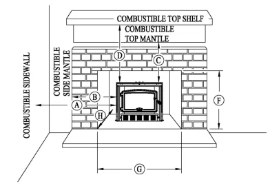

Insert flue collars are on top of the unit though a few have them angled a bit toward the back of the stove. We need full dimensions of the fireplace and surrounding trim in order to make suggestions. Here are the critical dimensions needed. Can you post a picture of the fireplace too?

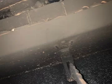

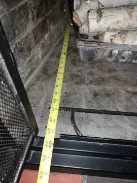

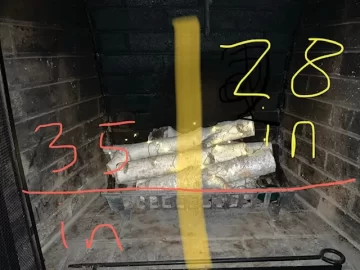

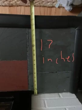

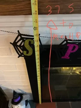

Thanks. I hope these pictures are helpful. I am most concerned about not having combustible clearance. I have 17 inches of "blue stone: in front of fireplace and about 36 inches from bottom of firebox opening to wood trim on mantle. Thank you in advance. I appreciate the advice

It looks like there is plenty of room for options. The main thing to watch will be clearances to the trim and mantel. If you don't want to extend the hearth, then a flush insert is the easiest solution to work with.
