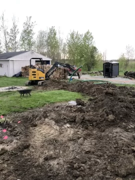

I rented a core drill and it took a chit on me. Sledge to the rescue. I also ran a 30amp service to set a plug by the boiler for my camper, I’ll be setting a post with a small outdoor breaker box to feed the boiler and power to the shed I’ll put up beside it.
View attachment 243996 View attachment 243997
I ended up using a set up that looks like chainsaw with a water hose connected to it for cooling and dust remediation. It worked quite well ,expensive chain though.
Concrete coming Friday morning. I think it’s only supposed to be 97 degrees with 100% humidity. I ran patrols in Iraq in 120+ degree and I’m dreading it.
At least you have a pool to cool off in! Are you going to use this boiler to heat the pool as well?
I do plan on it. I’m going to make a line set to do it. 4” field tile, pex, and foam insulation. I’ll roll it out when I want it and roll it back up and store in the barn when I don’t. I refitted a bunch of air compressors years back and have about 20 sets of 1 1/4” brass quick connects for airlines. Figure out a way to use those.

Do you bolt that thing to the slab?
I have not found anything that says I have to.
I just saw the drill and thought you were dropping red heads in. It should be heavy enough to not blow away!
It might not, but I see some airlock potential in that high spot above the pump.
