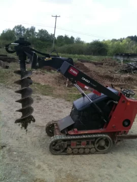

I have a Toro Dingo with a 14" bit. It drives the bit well without stalling. I've planted many small trees with this .
I've seen up tp 36" bits for these machines.

Little powerhouses they are. Rented one configured as a trencher. Ripped through shale installing drainage under a golf course fairway. Did the work of a much larger machine.

You don't realize how many uses they have until you own one with a bunch of attachments. I like the tranportability of it with a 3500lb single axle trailer also. It gets used between the shop and store which are 10 miles apart. Pulled behind an S-10 shop truck.
I've never checked rental fees but I'd bet they'd be half of a skid steer. The lifting capacting may be an issue with bagged and balled 5' trees.

I'm definitely going to check into one of these. Lifting capacity is no problem, as I have a 3000 lb. tractor with front-end loader to move the trees.
