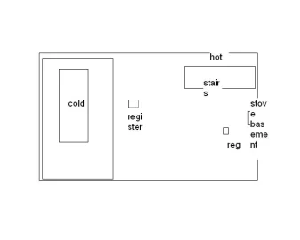

So I have another issue looking for advice on. I have a 2 story house. small 650 sf per floor and has a full basement. the stove is in the basement. the chimney is on one side of the house. that side stays 80 to 85 degree's. other side 60-70 degrees'. even in the basement like there is a wall half way and the temp drops. the basement is all open. I have fans going but the heat doesn't seem to go the other half. I leave the basement stairs open and tons of heat goes up the stair which again is same side as the stove. I have put a floor register over the stove. one half way in the kitchen. up stairs is not open concept. then a register up stairs above the stove side. the register in the center of the house actually is cold. i could feel cold being pulled down to the basement from it. I believe it pulls cold from the other side not allowing heat towards that way. any suggestions to get heat to go that way so it evens the heat through out the house better?
Do you have a box fan? If so, try this. Place the fan over the kitchen register blowing down on low speed. Close the cellar door so that a convective loop is formed.
Note this will only work if the kitchen register is large enough.
Thank you. have tried. this. my registers are only 12" by 10" which maybe to small. thinking i may need to close the kitchen one and put in a bigger register on outside wall in living room.
