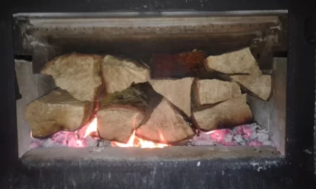

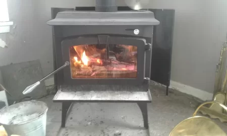

I am very satisfied with my Pleasant Hearth 2200 sq ft stove. It has secondary burn tubes and puts out a good amount of heat in my leaky 1890's farmhouse. Glass stays pretty clean with the airwash and I only had a coaling issue that 1 frigid week when I was running the stove hard. I have learned to open up the air supply at the coaling stage which turns them to ash much quicker.
The stated burn times are a bit off I discovered, but have adequate coals in the morning to relight after 8 hours but find myself reloading in 4-6 hour timeframe during the day mainly burning ash, oak and maple. I have been able to get a few 12 hour burns when stacking the firebox tightly. Quality is great for a lower priced unit and I got mine on sale at TSC back in Oct. $1,000 CDN which is $789 US.
I am using 16-18 inch splits east-west although it will take up to 20 inch, but will only hold 14 inch if you place them north-south. Easily keeps my stove room in the 70's during the real cold with my attached kitchen being about 10 degrees less. But keep in mind this old farmhouse has single pane glass and 10' 6" ceilings. The included blower is noisy on high but ok at lower speeds, but you can still hear it. I just turn the tv up...lol
I actually do use the ash pan which is actually quite large but is only practical when stove has died out as you have to lift a firebrick that has a little eyehook in it to access the pan. I use the tip of my poker for this. I would recommend this stove to anyone without hesitation. However I was using an old 70's smoke dragon before so really cannot compare mine to other modern stoves. I seem to be using less wood and have gone through just over 2 cords this season when I normally would be into cord #4.

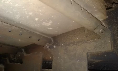

Does the PH have removable baffle, air tubes or blankets for cleaning the chimney flu from inside the stove?
The smaller PH in this vid looks like it does not have a removable baffle. And the manual does not list air tubes or baffle parts. However, it does say to make sure the baffle and blanket are pushed all the way back.
3:40 mark:
Good question. This is my first EPA tube stove so I have not found this out yet. Been cleaning from top down by disconnecting telescoping pipe from flue collar. From looking at the pic it appears tubes are held on by cotter type pins and baffle sits on top of tubes with blanket above that. I know the baffle sits freely as I did have to push it to the back of stove during install as it had shifted during transport. By the looks of it the front 1 or 2 tubes would need to be removed to tilt the baffle for it to slide down and out the door.
[Hearth.com] Pleasant Hearth and Englander 30-NC /Timber Ridge 50-TNC30  Info
