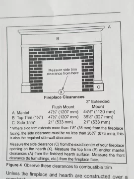

It's a very simple question. What exactly is the meaning of 'B. Top Trim (1 1/2")' in the specification pictured below?
Does that row of clearances apply if
(a) the top trim sticks out *more* than 1&1/2 inches? or
(b) the top trim sticks out *less* than 1&1/2 inches?​
If your answer is (a), then what is the clearance requirement for flush trim? Is there no limit? Can my sheetrock go right up to the stove?
I'm asking because I believe my stove is installed unsafely. The installer insists it is fine. Vermont Castings will not help me iterpret this specification*, or state how close sheetrock can be to the stove. They say it is up to their dealer/installer network to answer all "technical support questions". However the dealer has no incentive to tell the truth and admit that they made a mistake.
How can a company refuse to interpret their own ambiguous specification?

That's a tough one, you would think that if it was 1 1/2" or greater then there would be a note that references it like they have for the side wall.
I would just measure and insist that there should be nothing combustible for a flush mount install less then 47 1/2" and 36 1/2" if the unit is "extended out"
Come to think of it, one would think that if the trim is greater then 1 1/2" it would be considered a mantle?
I would fire up the stove as hot as is safe for the stove to fire and then take a temperature reading on the mantel after an hr or so.
Yeah the OEM should better interpret that diagram for you - if they won't, blast them here so no one else buys their stuff.
I interpret it as top trim projecting no more than 1 1/2". That is fairly generous. Some inserts say 1" of less for the mantel trim. And no, a combustible can not go right up to the stove.
Exactly. That's what I said.

The OEM is responsible for installation parameters, so Vermont has to be the one that interpretes the spec.
I agree! But VC explicitly refuses to make a statement on the spec. What options do I have?
They told me to talk to the installer, who said (and I quote from an email)::
VC Improved Dealer and Installer said:
The clearance is to a top trim that is 1 ½” or more, not less. We have done many of these installs and we wouldn’t have left your job this way without letting you know you would have had to do something. Sheetrock could never go down to the fireplace opening, there is a clearance to each side and top which is usually about 6” needed.
They claim there is NO manufacturer spec for flat trim, so they use the "about 6" rule"
I followed up with Vermont Castings and told them that my wood trim gets 200+ without the fan so either a) their installer is lying to me, or b) their specs have a safety issue. VC told me "I'm sorry but we cannot help you further."
Can anyone think of another way to get an official interpretation of the spec? I'm assuming that the installer is lying, and VC is covering their ass to avoid admitting an ambiguous spec. Also, BTW, the installer is a subsidiary company of VC.

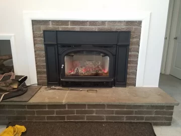

Yes. It gets very hot. The wood trim (which sticks out about 1/2") gets 200F+ if I burn it without the fan.
200º is too hot. How was this measured? Can you post a picture and include the distances from the stove to the mantel trim both side and top?
I measured it with the Etekcity Infrared Thermometer. It was 201 with the fan off. At that point I shut down the fire because I was worried. I usually use the fan so it's not that hot, but it's still too warm. And since I can't run it without the fan it means I can't use it in a power outage.
A picture of the fireplace is attached. My hearth-to-top trim is 32.75" - that's 14.75 inches short of the VC spec... depending how you interpret it.

To avoid the risk of pyrolysis, nearby combustibles should not be more than about 165º. I interpret their clearance for the trim as up to 1.5" thick. Note that they provide a special case for the side trim if it exceeds 1.5" in thickness. For a flush mounted insert the top trim and mantel distance is the same 47.5" according to the documentation. It looks like if the insert has the extended 3" mount then the to trim clearance drops to 36". The extended mount appears to have a top cap on the 3" extension which must act like a heat shield.

I don't see how any top trim could be closer than the 36 1/2" spec for a 3" extended install. If yours is 32 1/4" then it is certainly not within specs.
I would interpret that you need 47 1/2" from the hearth to any combustible above the insert with a flush install.
I'm thinking that the trim is heated by convection coming off the front of the stove and if you want to cool off the top trim to stick a baffle/spoiler on top of the stove to cause some turbulence and mix the air up more. Of course your insurance company could probably still deny any claim if your stove isn't to spec...
Agreed. Bottom line is something has to change. The current mantel is just a picture frame. It should be pretty easy to replace it if there is a clean brick face up to 48" above the hearth. If not, at the least I would add a mantel shield.
Agreed... at the least I would add a mantel shield.
There are no bricks beyond what you see.
I will try a mantle shield. Are they best added near the stove? Maybe just something sticking out from behind the stove surround?
Yes, the bottom edge tucked behind the surround will work. The shield should extend at least an 1" past the mantel trim.
Any old sheet metal will do? I don't need some fancy heat-reflecting design?
No, nothing fancy. It should be a decent gauge to hold its shape. I would use at least 22 ga. and paint it. But as a test a lighter gauge would work. If you paint it use a high temp paint. BBQ paint would work.
