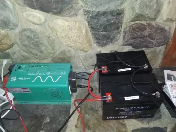

I have small 1k Inverter Generator for longer than 12 hours and couple of 100ah Batteries for Shorter Outages. Run thru Inverter/Charger (AIMS 1250). Longest I have had to use it is 10 hours. Your stove won't use much power running. Even 1k generator will be enough. Key is Pure Sine Wave so you don't screw up the computer in Pellet Stove
