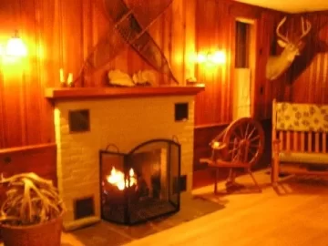

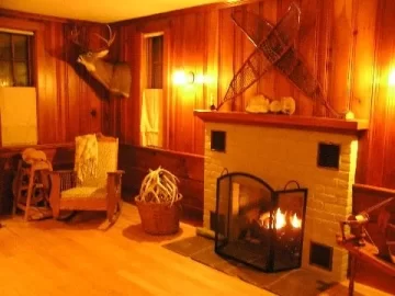

I sure hope these pics aren't huge. Many apologies if they end up that way and I'll try to fix them. This is my living room with vent free gas logs in use. (2 views) The gas line would be removed, and the slate on the floor is going to be extended for the stove. I'd love any feedback. Thanks.

Here's the second angle...

thats a heck of a big basket of backscratchers!
Great looking livingroom!
What are the dimensions of the fireplace?

Thanks! That's what you get when the guy in the house is a wildlife biologist/forester. I really like the room too, it's very masculine and cozy. (As an aside - my vocation is sitting next to the fireplace - one of my 4 spinning wheels.)
Fireplace (with vent free gas logs in action - 99.9% fuel efficient) dimensions:
Front width = 32"
Depth = 16"
Back width = 28"
Height to brick = 25"
