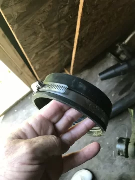

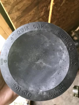

Get yourself one of these at Lowe’s or depot as mentioned above and remember to cover up your air intake too. I also put a damprid inside the stove

I never thought of a fernco fitting! That would be perfect! I have some damprid, but didn't want to throw it in there until I stopped the airflow down my pipe.

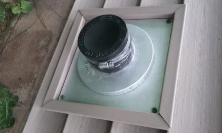

This afternoon I went to Lowe's and bought a 3" Fernco endcap. It cost about $5.00. Slapped it on and problem solved! Thanks corkman!
