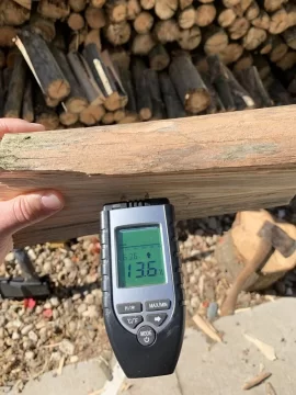

Here is a moisture reading on a fresh split that was sitting inside at room temperature. The meter could be inaccurate? But it’s from standing dead white pine trees so I assumed it was pretty accurate. The 1/3 cord of wood I burned last March was hardwood left by the previous owner, that measured around 20%, some of it slightly over 20% but it’s all I had at the time. Maybe that was a mistake.

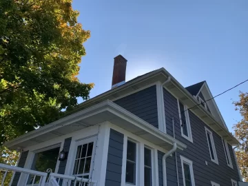

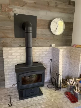

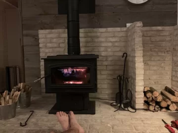

Thanks for all the replies. After a bit of trial and error it seems that I mainly have this issue when I do a cold start in the morning. Once it’s up and running it seems to not blow smoke in much at all on reloads. I’ve done a couple of top down fires where I close and latch the door immediately after lighting it and it seems to burn through it pretty well (I used to always keep the door cracked for a few minutes which was letting smoke in). I attached a picture of the inside and outside setup since I don’t know much at all about the chimney configuration. I’ll also mention that we have an electric heat pump on our second floor where the bedrooms are and we run that at night, so could there be an issue with the chimney being warmer further up and colder down on the first floor where the stove is that could cause draft issues in the morning?

The fire looks good. This could just be outside temps. Once it gets about 10º colder draft will be stronger. For cold starts, try top down lighting. It gets the flue warm quickly, and with less smoke.

Chimney height and horizontal run seems fine. I concur that this may be an outside temperature issue; warmer temps decrease draft.
