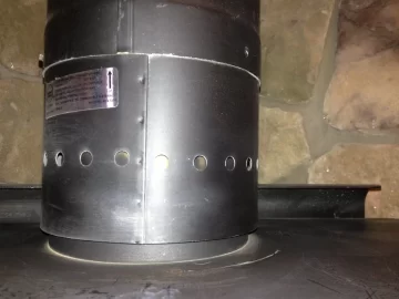

Ok so like it says ,im having a problem with smoke in the house. I have a country striker s160. In the beginning of the season I didnt notice any problem like this, but I did clean the chimney before I started burning.

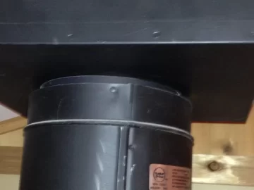

I am noticing 2 things here.The first is when I am starting a fire smoke pours out from what I think are the secondary vents, at least that is what I think they are, behind the side panels of the stove and they go to the pipes inside the stove with air holes in them?The smoke leaking from these vents will last from 1-2 minutes until the kindling really takes off. The second is Im noticing smoke leaking from between the ceiling support box and the double wall slip pipe. This worries me a little more because it will continue to smoke even after the stove is up to temp. It doesnt just leak smoke all the time, but there is the occasional big puff of smoke from it.
So this is what I think is happening. When the joint between the ceiling box and the double wall pipe is not blowing smoke into the house, it is probably pulling colder air into the pipe. Then causing excessive creasote to build up fast and cause the lack of strong draft to keep the smoke going up and out.No matter how slow I open the door smoke pours into the house. When I did clean the pipes they were pretty clean untill about the roof line then got very dirty.
Now the possible fix. I can grab the slip pipe and move it about 3/4" up untill it hits the box, and spin it around. Should this be like that? Since it is double wall slip pipe can I just take out the screws, lenghten the pipe, and put new screws in? The old holes should be no big deal right, they dont hit the liner.It is supposed to warm up here this week, I will clean it again and see what happens. I am going to try and put some pics up but I cant guarantee anything. Any help would be appreciated, I love the heat, but im sick of dealing with the smoke. Thanks Mike [Hearth.com] Poor draft? Smoke in the house[Hearth.com] Poor draft? Smoke in the house

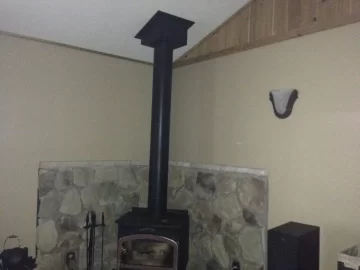

What's the total length of your chimney? Any horizontal runs in the pipe?
Sounds short, the manual list any minimums? I took a look, if you are at 15' you are at the minimum. Consider adding a couple feet?

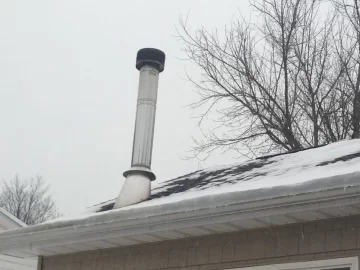

Can you post a shot of the chimney on the roof? That may also give a clue.

You have an adjustable stovepipe. Simply remove that section (which you want to adjust anyway), take it outside and clean it. Attach a heavy trash bag to the support box with duct tape. slit a hole in it to one side, near the top, big enough for your chimney brush to fit through, and sweep from the bottom. The creosote will all fall into the bag. Take the bag off, seal it, clean up any stuff that has fallen on the stove or floor (won't be much...perhaps a small dusting), reattach the pipe, hopefully with a slightly better hit than you now have. Add a few feeet to the chimney as soon as the weather gets better.

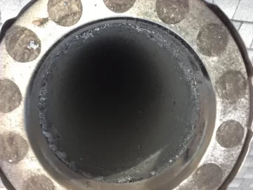

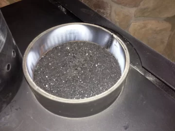

Rotated pics. Hard to be sure but that cap looks plugged to me.

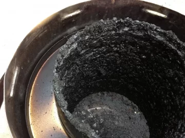

Thank you for rotating the pics. I cleaned the stove and pipes today and it was surprisingly dirty for such little burning. I did notice that at the joints it was built up more than the rest. And the cap was pretty bad. The first pic is of the inside of the cap. The second is from the roof looking down. The third is the creosote that fell when I cleaned the pipe.
