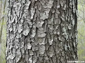

What is the species? Most on here talking about cherry are going to be talking about wild black cherry native to the eastern U.S. Prunus serotina

I don't think you have this there.
https://en.wikipedia.org/wiki/Prunus_serotina
I would pretty much say the same as Woody Stover... it's about in the middle of the chart here. Medium output, better than all the softwoods I think but towards the bottom of the hardwoods. Could go overnight in my tube stove just fine, and produced good secondaries. I didn't notice it to be more ashy than most of the other stuff I burn. Smells a little nicer to burn too. I enjoyed splitting and burning cherry. :)

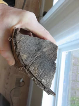

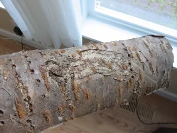

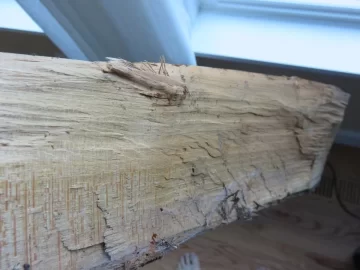

That's Cherry! Almost looks like it has been seasoned or, at least, cut for awhile. I always leave it in large splits, or logs as I like it for the over-night burns. Cherry, like Alder, can get "punky" (start to rot) really quick. If that piece is rather light weight, that may be the case. It will still burn, but not as good as a sound & solid piece.
