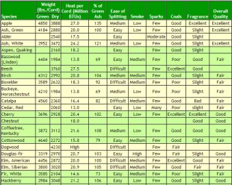

We burn Aspen here sometimes because A) we're not bestowed with deciduous forests full of Oak and Hickory and B) its pretty plentiful. It also pretty much splits itself which is nice.
Aspen provides around 18 million BTUs per cord. For reference, White Oak: 29 million BTUs per cord.
Source: forestry.usu.edu/htm/forest-products/wood-heating
Also, dry time is mostly dependent upon relative humidity thus low relative humidity of a semi-arid climate like Colorado equates to very quick seasoning times. East coast is much longer. Aspen contains quite a bit of water so it takes a bit longer to season when compared to something like Ash.
