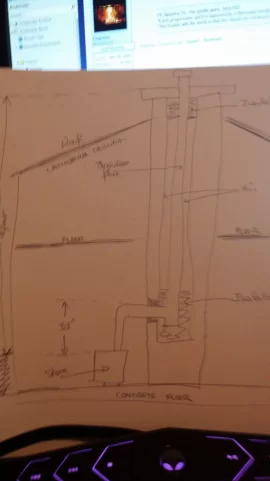

Let's consider the draft. We'll need to know exactly how the stove is vented. Describe the flue system, starting at the stove and all the way to the chimney top.
I decide to include a drawing if you need clarification please ask

Good start. What is the height of the liner? Is it 6" stainless?
Nevermind, I found it - 18ft correct?
So the flue install is on the cusp. 18ft is good, but it is countered by the double 90 starting off and a basement install. Two 90 deg turns in the smoke path are going to add enough resistance to act like someone effectively lopped off about 6 ft of the pipe. The double 90 can be slightly improved by using a pair of 45's with an offset to connect to the thimble. And/or ou might also want to add a few feet to the top.

Your effective chimney height is about 12-3 ft due to the double 90 turn.
So is adding an extra 18" enough to increase the draft? Or should I combine that with 2 45 degree elbow? What are your thoughts?
I would combine it with the two 45s for best effect. Something like this:
