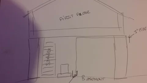

ok, this unit is in a basement right? best case for this little trick.
you will need some 3 inch PVC (legal for this as its not connected directly to the stove) a small patch of screen (anti critter type)and a 5 gallon bucket
locate a suitable position in relatively close proximity to the stove drill a hole in the sill plate that the PVC will pass through and screen it on the outside , elbow down along the wall and stop about 3 inches from the floor inside the bucket.
this will allow air to come in through the pipe but the air coming in will be cold , so it wont "rise" out of the bucket by itself, its trapped there because its colder than the surrounding basement air the house (and flue) need some air , the air will be sipped off the top of the bucket and more will come in to replace it so the house will only take what it needs for neutral pressure. this will give the flue a stable supply of air while at the same time you have control over where the cold air is when its not being drawn by the flue.

I made a drawing of what I understood. Did I understand you correctly? [Hearth.com] Possible draft problem.
yeah, pretty much though you don't have to get that close to the stove , how far is the stove from the wall you represented the pipe going through?
about 10 feet to the South Wall. I want to use that wall because the air intake will be protected from the wins since there is a floor above it
And since I have to remove the mortar around the 90 degree angle in the chimney I am thinking of changing it with a 45 degree angle. http://www.chimneylinerdepot.com/store/839/product/6-inch-45-Degree-Flex-Liner-Elbow.html
thats probably close enough, remember its ambient pressure we're releaving down there not really providing direct air to the flue just allowing replacement air into the room should be sufficient, dads is about 8 ft away and it does fine , that way you wont have a longer pipe running along the ceiling.
