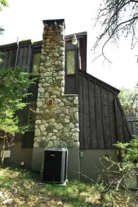

Here is a picture of the chimney. Do you think the stainless pipe or extend-a-flue would look good up there?

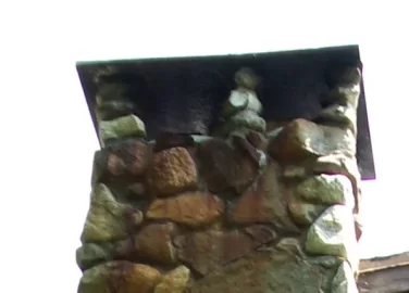

Here's a closeup of the chimney top.

Nah, that is a nice looking chimney. If you are going to mod it, do it right.
Why not try it out for the winter with the changes made so far? 2 stories of insulated flue should make a nice difference.

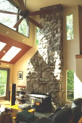

The only difference between before and after was going from a 6 inch corrugated flex pipe to an 8 inch non-corrugated pipe. The pipe was insulated before and is now as well, although based on what I saw when they installed it today, it appears they might have done a better job at insulating this time. I'm hoping the 8 inch pipe will make all the difference, but my girlfriend who has asthma had a very hard time last winter due to the constant incurable back-puffing, so I want to get it as 'right' as possible. Do you believe that extending the liner another couple of feet can make a big difference in the draft as well? I've attached a picture of the inside for reference (note high ceiling).

If you go higher for sure use insulated pipe. If you don't you are gonna have a plugged up mess in that last two feet within two cords of burning.
A insulated Extend-A-Flue would be perfect for it both for gaining height and aesthetics. If they are even still available. But the slab would have to go.
Edit: PS I would dearly like to see more pics of that house. It sure looks nice.
