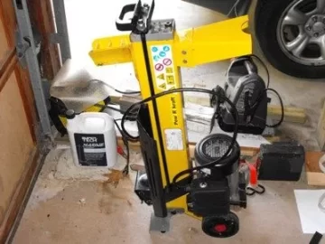

Here's a picture, I'd sure like the larger wheels I see on the recent model. [Hearth.com] PowR Kraft 4 Ton Electric some jitter, loss of power
I am yet to give it a try following the tightening of the nuts on the rods, the RH one was very loose - RH looking down at the handle.
Here's a picture, I'd sure like the larger wheels I see on the recent model. View attachment 107163
The two rods pull the ram (and thus the log) toward the splitting wedge. All of the hydraulic force is transmitted through those two rods, so if they're not equally tight, they'll be pulling at an angle to each other. Seems to me that could certainly cause your jitter.
Dan, I hadn't thought about the push/pull nature, but what you say sounds right. The hydraulic piston is in the center and it pushes on the "handle" and thus pulls on the two rods, as you say. The ram must also rest on the beam, but it hasn't lost any noticeable paint.. hum, I'll take a closer look.

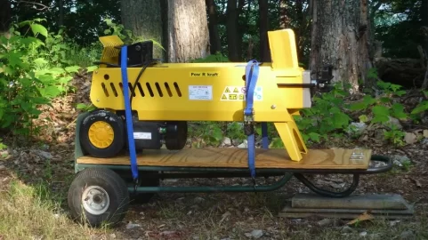

I like the hand-truck idea, I may cut some plywood to fit my hand cart and strap the splitter to it. Great improvement for moving.
Dan, to you split with the splitter on the hand truck? The straps would have to be moved, so what holds it down//on? If so used.
The ground in WV at my cabin is very rocky, so I put the splitter on the hand truck to move it from the shed to where I split. I'd like to have even larger wheels on mine...they work fine on pavement, but not on rough ground. Let me know if you find a way to put larger wheels on!
As to splitting, I remove the splitter from the hand truck to split, putting the splitter on the ground with the wedge end elevated slightly. I've found that I can put a really heavy round on the hand truck, park it next to the splitter, lay it back horizontally, and then roll the round from the hand truck onto the splitter. They're almost exactly the same height, so it makes for easy handling of rounds that weigh over 100 pounds (even 50 pounds is rough on your back, when you're bending over).
The photo was taken the first day I used the splitter. I tried using it while it was still on the hand truck, but it was too unstable. You can see the boards I put under the handle of the truck, to elevate that end slightly.
