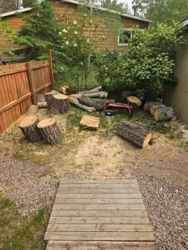

I've had my 5 ton homelite for 15 years now splitting 4 cords of pine yearly.i turned the boost up on it so it works better.recently had these big trees cut down and its struggling with these big pieces.
