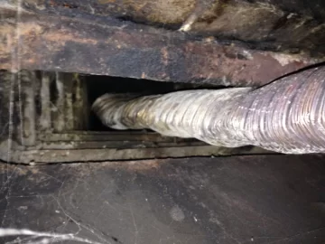

I started out with small 4 inch damper frame and cut it out and chipped some fire brick out to allow 8 inch insulated liner in there

Excavator excellent angle showing damper frame. Looks like you did a small block plate just covering existing 4" gap. Is that any less effective than a full block off plate like the ones that fill the entire fireplace cavity at lintel level? As for flex liner I'll prob keep it simple and just get some basic flex king with insulation kit. Are eBay vendors trust worthy ? Haven't used evil bay for anything in awhile. Have not seen anything really stating 1 or 2 ply or the more expensive smooth wall liners are better. I'm sure they are but if the basic flex liners do their job just as well than that is good enough for me

No way to say other then the block off plate I fabbed up keeps the heat down in the house and not up the chimney. It works great

tj, yes if you can put the block off at the original opening, that is the best way to go. Easier and less material and work if you can reach up there and work it.
It really is no less effective. The goal is to keep the heat from migrating upward and transferring out along the length of the masonry above.

Well another question here. In the pic is it possible or safe where the thinner section of the damper frame. Can I take my grinder and score a couple bricks with a line parrellel with damper and chisel them out? I think that would give me a near straight shot down! But I want to make sure structure wise that it is safe[Hearth.com] Pre insulated liner
Guess best way to describe is the top part of damper frame as in pic which is actually the exterior side and the larger metal is toward the living room. Ha if that helps but I figure knocking two bricks down where I will be cutting would garuntee zero ovalizing and also allow less bend and I could tuck the 30 farther back in fireplace. May make block off plate a bit different tho...
