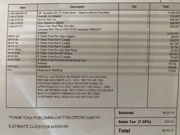

I’ve got a quote supposedly on the high end for a new 52i insert in Majolica Brown for almost $8800.00 and was wondering if this was a expected price range for this appliance. I was going over the quote, and it looks like a lot of the prices for the piping are pretty high in my opinion. I’d really like to get this stove, but almost nine grand seems a little steep. Any advice would be appreciated. Thanks

Hello, it’s going to need the zero clearance box for sure. I’ve got the gas line unhooked to the gas fireplace already. I was thinking more in the line of the $6000.00 range myself. I’d thought the pipping was outrageously priced. I’d sent a picture of the bill breakdown. I’ll send it again. Almost $8800.00 is just to much.

Looks like a service rail kit is included. The pipe is expensive for the good stuff. That is a big job to install. Demo a gas fireplace and install a ZC box and stove includes all pipe, outside air kit, Service rail kit, Porcelain brown color. I see where that all drives price up. The $6000 would be for a black stove in a single story masonry fireplace with a flex liner. Installer is starting with less than nothing because he has to demo the gas unit 1st. Then see what he has to work with. If you are looking to save money without sacrificing quality go with a free standing and go thru the wall. The itemized cost dont look out of line. You could save well over $3000 going thru the wall w/ a P43 I would guess....
If You are getting the Harman outside air then you need a 3” Outside Air Kit. I do not see that in your quote. What is up with that??
It looks to be there. Line 2 is the outside air kit for stove then line 5 is the pass thru box with outside air included. just need duct for stove to box.
Line 2 is the special internal air adapter that connects the air inlet pipe where the flapper valve is to the frame that resides in the fireplace.
Line 5 looks like the OAK kit but it must have a 3” flex hose to connect to the frame. You may want to make sure.

Check to see if there is a factory rebate/discount available. I think there is. But still will only lower by a couple hundred. If you go with standard black and dont include rail kit that will save approx $800. When demo of a existing unit is involved it is hard to give a firm cost. It did say worst case. May not need the ZC box.
