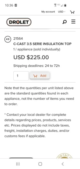

What is a c-cast panel? I never heard of that term. My stove appears to just have the 5/16" stovetop....but one of the diagrams in the manual shows a dark line attached to the underside of the stovetop. That could be it. I'll have to look closer when the tubes and baffle board can be removed.

It looks like your model doesn’t have the c-cast panel. It's not listed in my owner's manual, but it's on Drolet's site for parts:

I think they added it to protect the stovetop from flames
