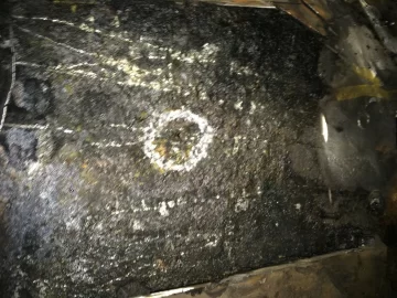

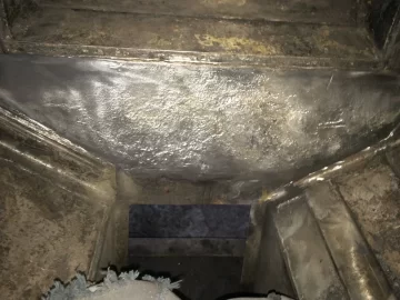

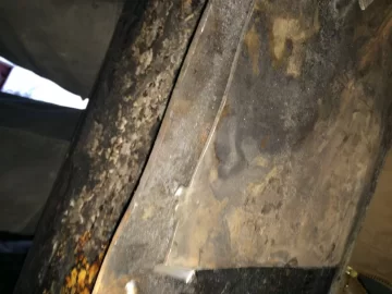

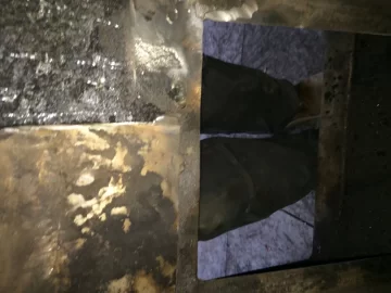

I recently bought a house with a empyre elite xt 200 stove, the guy purchased it 5months previous. So come oct I got the stove going and after 2 weeks of start up it was leaking water like a sprinkler! I contacted pro fab and they were so nice to tell me that it's a NON transferable warrenty! Stove is 5months old and I was told sorry bout ur luck. After dealing with the head boss (grant) I was given a small portion of $ for repairs which was about 400$ short of what the bill was! I was happy that I got some money but it was a brand new stove that costed lots of $$$ shouldn't have been leaking already!!! the company wasn't willing to help at all with fixing it other then here's a few bucks try and fix it. It came down to the point where the head boss (grant) would not answer any of my calls or respond to any of my messages! What kind of company wont do what they can to keep there customers happy??? PRO FAB! In the end the whole issue was a weld that the company forgot to do...once the cresote and heat got between the water tank and stainless skin it completely deteriorated the water tank! If anyone is interested I have pic to show, whole stove had to be gutted! They tried telling me that my water wasn't treated properly and that's what ate the metal.... Sorry pro fab that wasn't the case! I offered to send all my pics from start to finish and all the steel that had to be cut out to prove to them that it was manufacture error. The steel on the inside of water tank looks brand new, but that's when grant decided he didn't wanna talk to me anymore. Filed complaints with the BBB but go figure pro fab wouldn't reapond to them either.

... In the end the whole issue was a weld that the company forgot to do...once the cresote and heat got between the water tank and stainless skin it completely deteriorated the water tank! If anyone is interested I have pic to show, whole stove had to be gutted!

Would appreciate you posting the pic ... folks with the same boiler will be able to pin-point a potential trouble spot in the future. Hopefully your problem is a one-off ...

First time user so not sure if the pics worked or not...if they did those are pics of inside the fire box. Pic of a cut away of the stainless, pic of all the cresote behind the stainless, pic of the water tank after all the cresote was chipped off, and a underside pic of the stainless seam that wasn't welded...
