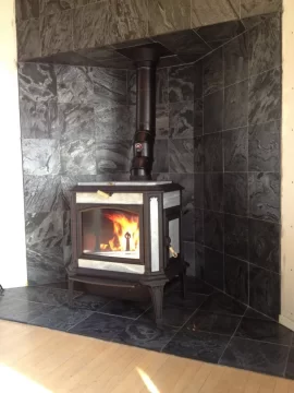

I have the pan. Although I have nothing to compare it to (first stove), I can't imagine not having it!! Huh? "Shoveling ashes"? Forget that,doesn't sound appetizing to me. I just slide it out and dump it outside. It is very big, and very functional. Lastly, the looks probably depend on your colors, particularly around the stove (aka tile...). You can't really notice my black pan against the dark slate tiles. Lighter colors prolly show it more, but I would not go without it, now that I have it.

I would never go back to shoveling ashes after using the PH ashpan.
One more thing, I have recently found that I get better and longer burns with very little ash in the stove. I know that goes against what everyone around here suggests, but that is what I'm seeing. I rake almost all the ashes thru the grate before each reload now.
And, with the ash pan, there is no need for having/storing/dealing with an ash bucket in the house. I just dump my ashes outside one every week or two, and slide it back in. Done.
