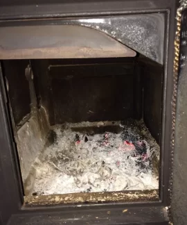

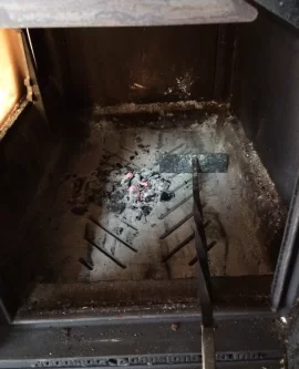

Wow, never knew about the front center bottom air hole! I'd guess it was blocked since the ash bed was a least 3-4 inches deep and I didn't make a point of pushing ash away from the front window. So to reply - i'm assuming " that the air supple WASN'T available from that source before I got the ash pan". BTW - emptied the huge ash pan after only six days of burning just tonight. Ash was clearly not falling through anymore, an the whole pan was topped off and level all the way across.Once again, helpful information. Thanks. Curious...when you were burning without an ashpan, did you make sure the air hole in the front center bottom was free of ash when the ash bed was deep? I realized sometime last year that it was frequently covered. Once I made a point of raking the coals and ash away, sharply, to keep the area open with a decent open space around, even when I had all the coals raked forward, I did find the stove burned better. SO, Fundamentally I am wondering if having the air hole open now that you have an ashpan at least significantly contributing to your better burns, or if you ascertained that the air supply was available from that source before you got the ashpan?

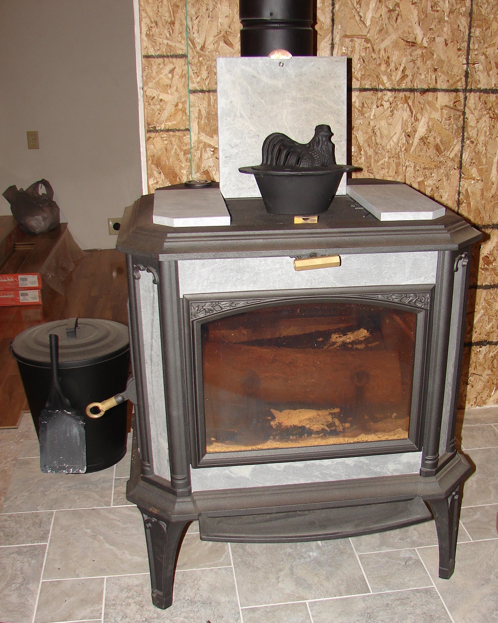

Thoughtful of Woodstock to send the paint. I'm sure it looks a lot better the same color as the stove. The pipe surely does. "Champagne" -- a custom color? Bet it looks very nice.
Re: the stove color - not custom, it is the stock 'metallic brown', but has a lot of silver glow to it. One of the gals at Woodstock described it as 'kinda like champagne'.
