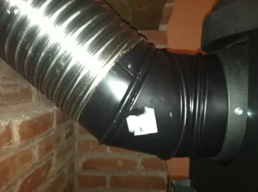

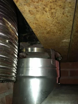

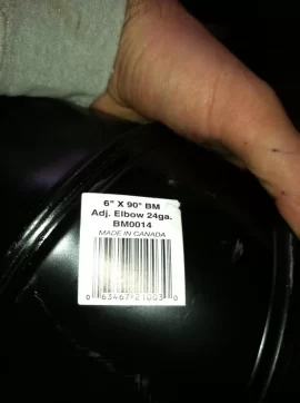

However I have run into another problem. I can't make the connection between the T and the flexible liner because the Lintel sits almost directly on top of the T. I think I have solved this by picking up a 24Guage adjustable elbow. I was able to connect that directly to the stove and also fit it into flexible liner. I'm a little skeptical of mixing components from different systems. Anyone have any safety thoughts/concerns on this connection?
Also I'm wondering for those who do run a T connection how do you clean the horizontal snout? Do you have to disconnect it from the stove? If this is the case I'm not sure I see the advantage of a T connection vs. what I currently have in place. Both require a disconnect to clean.
