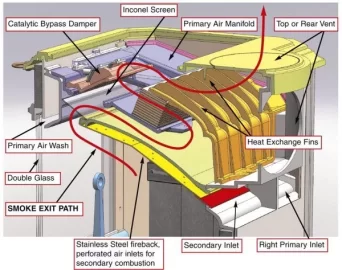

it's a great ash pan and it eliminates the cat clogging problem some have
I guess with the sled setup, ash is going past the cat. On my former Fireview, shovlin' ash went to the bypass, and away from the screen/cat.
I generally have to rake the ash/coals to get all the ash into the pan
